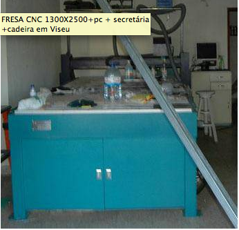

Advices on Suda VG 1325 Router Machine!
Although these pictures are very small and bad (its what i have been given) what can you say about this 1300x2500 Cnc Router machine, construction quality, etc.
I dont know the company that makes it, the only thing I know is the worksize. And im tempted to make a trip to get it, but i really need your help and opinions.

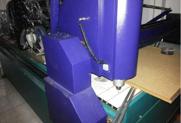

Prob an ok machine if the price is right, certainly a good starting point for modifiying/improving. To me it looks like an older chinese built machine, similer anyway. It has Hiwin profile rails and possibly rack and pinion drive on the x and y.
The size is great as you can use full sheets of ply, which is great for hack spaces as a lot of people design projects around 8 by 4 sheets.
I you are looking for a guide price I would guess around £1000-2000 if it doesn't work and maybe a little more if it does. You can buy these new from china for £6000 so don't pay over the odd.
A vacuum pump may be under that black plastic which would be a bonus, but I know the chinese ones do not work very well. A good vacuum pump for this machine could set you back £1000-1500 second hand or £2500 new.
It looks like there is no tool changer but that would also be a nice bonus if it does.

Shapebuster: Sorry don't know the make but Like others say it looks like chinese type machine but resonably well built, thou if that is the price then it's not really worth that sort of money unless it's fully working with Tool changer and Vacuum pump pump and even then I think it's not overly cheap.

Shapebuster: 3K seems fair price if it's all working.

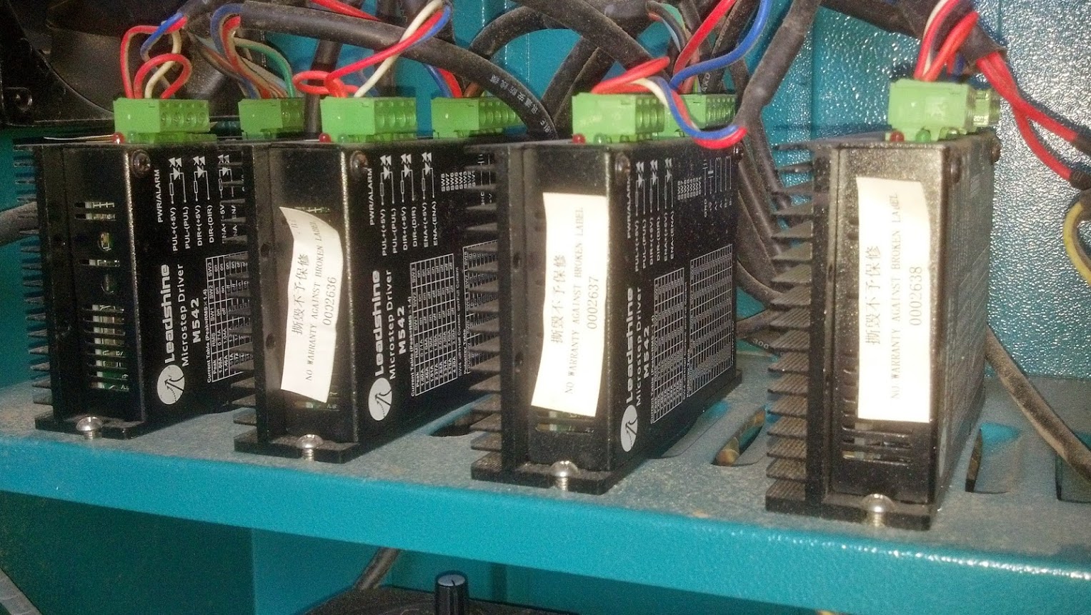

Things to look out for are just the obvious like Rusty rails, Sloppy linear bearings so grab them firmly and feel for movement, Worn teeth on Rack and Pinion, Check spindle turns freely and again grab firmly at nose and feel for movement.
Less of a concern but still worth Checking if wires are brittle or chewed by mice etc if it's been stood for some time.

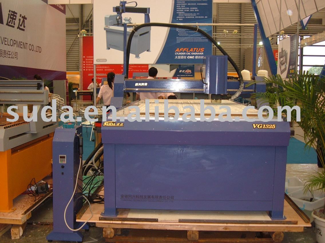

From what i have looked its as similarities to this one dont you think?
Attachment 12030
Attachment 12029
Attachment 12028
Maybe Its a older model of this SUDA VG1325 cnc router, from ONGXING TECHNOLOGY DEVELOPMENT Co
http://www.sudacnc.cn/offer/526836431.html
https://www.youtube.com/watch?v=EHYUWLCrrI8
With this specs:http://www.txgm.dpes.com.cn/product/2011/12/278.html
What do you think?
Re: Help needed identifying this 1300x2500 CnC Router Machine!
Yes that looks very much like the machine doesn't it. I noticed the weight is 1250Kg which i would say is more realistic than 750Kg. That's not overly heavy so should move it easy enough.

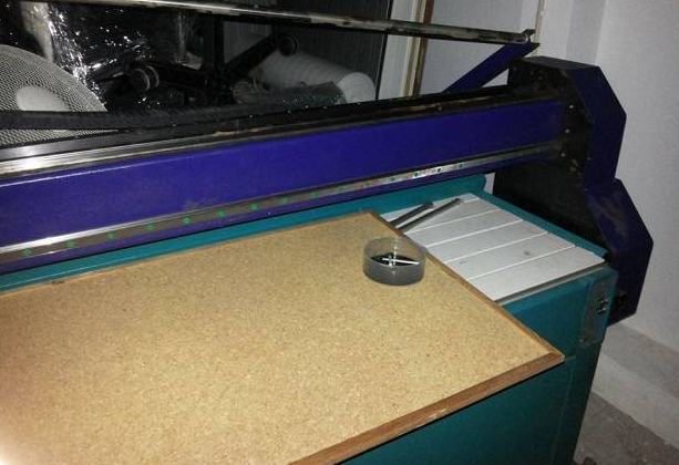

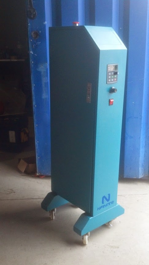

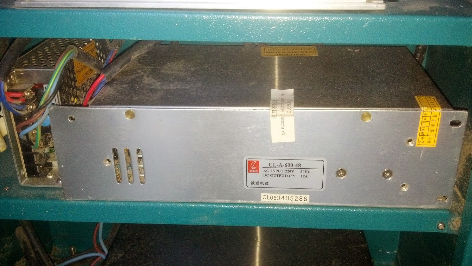

Yes it's just about what thought it would be for chinese built machine, not the best in the world but more than good enough for most small wood shops.
Nothing to add about moving the machine other than common sense lock every thing down.
Looking at the picture your machine as Hi-win rails which are decent quality so they shouldn't be wornout looking at the condition of the machine. Condition of Rack & pinion would be my main area to look at when you have it home. This will be the weak area on this machine either because of quality or poor maintenance and setup.
R&P wears very quickly if not setup correctly, often it's over tightened to eliminate backlash and this causes excess friction so wears the Rack. Or other way and not maintained and pinion is under engaged so wears tops of teeth away.!
Electronicly then can't say because it's like a box of Chocolates with Chinese machines "You never know what your going to get" but often they are one area they compromise to keep costs down.? Post pictures when you have it home and settled.

In your opinion which may be the major cnc working limitations of the machine? For instance will it machine 3d wood parts?
What improvements would you give it, and how much do you think it will cost?
shapebusters
Mechanicly There should be no limitations for the purpose it was designed for which would be mostly wood routing. It will easily handle 3D type work and anything in between. Without knowing the resolution the only area it may not perform so well in is fine engraving or detailed work.? This is due to using rack & pinion but I'd be very surprised if it couldn't do half decent job.
Does the machine come with it's own controller.? If it does this could be the grey area and how it handles large files that 3D work produce, it could also be an area where you struggle with post processing in CAM software. Or worse still it needs dedicated Cam software.!! If your new to CNC then post processing is where the CAM software formats the outputted G-code file to suit the Controller that runs your machine. In your case you may not know or the CAM have a post processor for that machine.
Often with older machines that have restrictive controllers or tied to dedicated software then it's easier to just retro fit with PC Software based controller like MAch3 or Linux Cnc.
Good luck with the move.
JAZZCNC
shapebusters
OK!:loyal:
Where am i supposed to get the power from?
The last picture you showed on the previous post is the VFD ( Variable frequency Drive) this is what controls the spindle. It takes 220-240V 60hz single phase power and converts it to 3 phase variable frequency between 0hz and upto 600hz depending on the rating of the VFD and spindle. Probably 400hz. This gives you the abilty to control the speed of the Spindle.
You can also control the VFD from the CNC controller and have the software turn on/off and set the speed. This does require other hardware called a spindle speed controller which outputs signals to the VFD.
Your control box may or may not have this.? If you supply good quality pictures of inside then we may be able to see if you have one or not.?

11 Attachment(s)
JAZZCNC
Here are the pictures:
Attachment 12186Attachment 12187Attachment 12188
Attachment 12189Attachment 12190
Attachment 12191Attachment 12192
Attachment 12193Attachment 12194
Attachment 12195
I have already changed the water cooling spindle tubes. About the cooling of the spindle can i use a Computer water cooling system?
