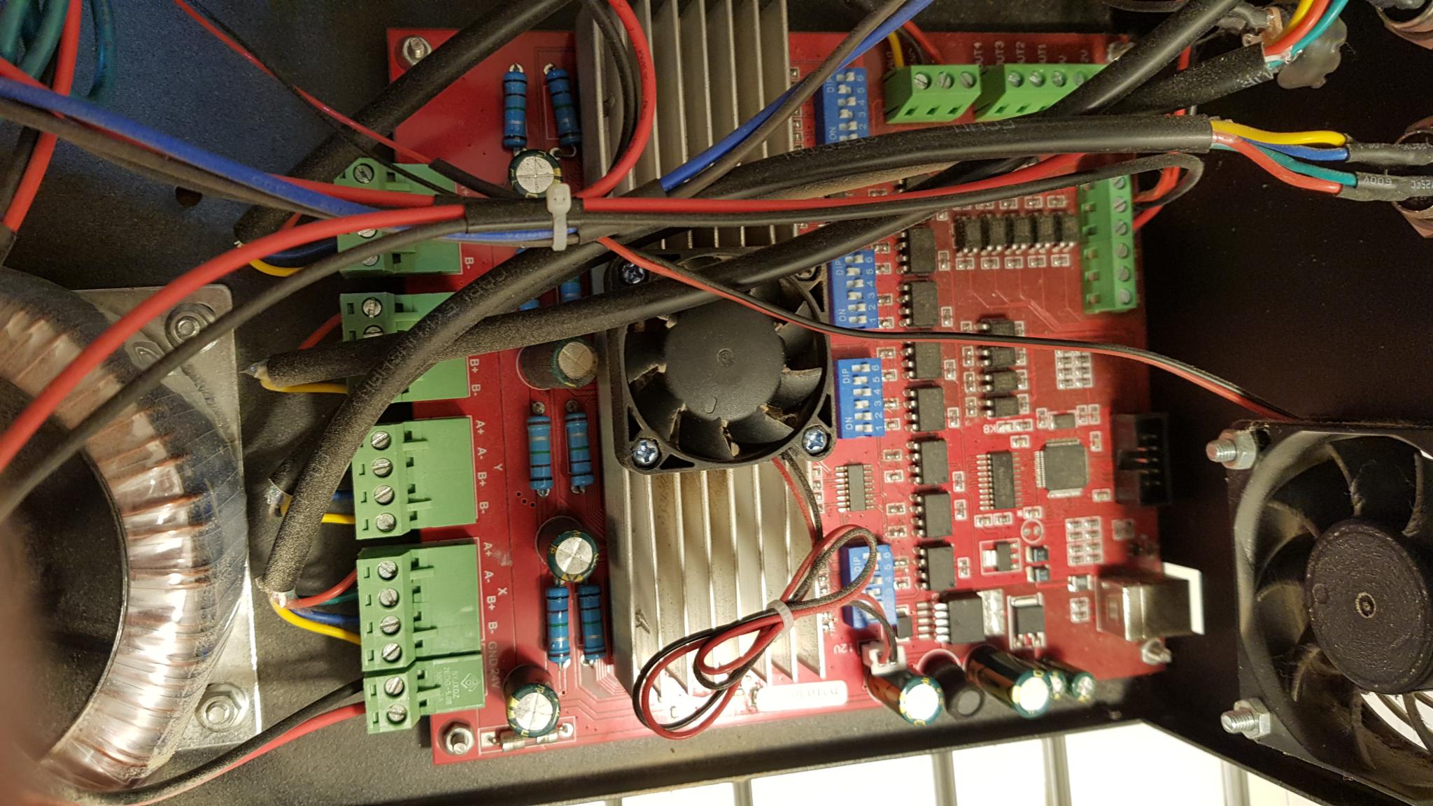

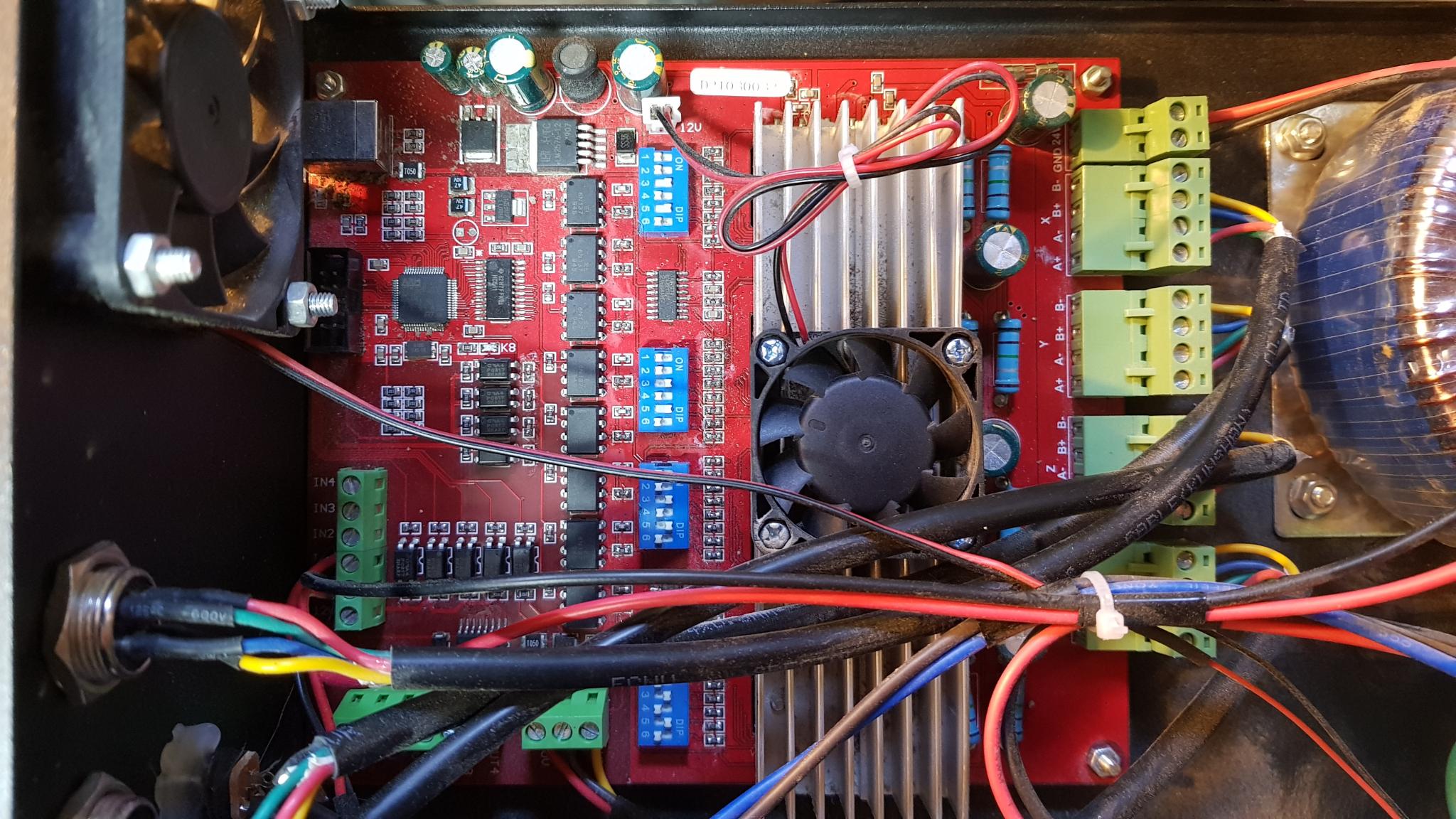

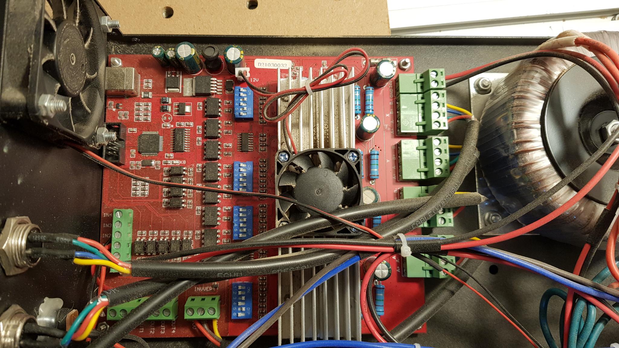

6 Attachment(s)
		Re: step and dir pulse problem Mach3
		This is what i have, what do i need and what do i have to take out....cheers
Attachment 30856Attachment 30857Attachment 30858Attachment 30859Attachment 30860
Just received my AXBB-E and i also got a 5v and 24v psu so all i need to do now is panic as i dont have a clue what im doing......Help
Attachment 30861  do i keep this board as it has the X Y Z axis attached
UPDATE.....Have connected Axbb-e to the 5v and 12v power psu and also connected network, so now need to build a bigger controller box so all will fit in.
mrmacca
 That is an all-in-one board with controller and motor drives combined so you can't use it because you can't control the drives.
To use with the AXBB-E you will need separate drives.

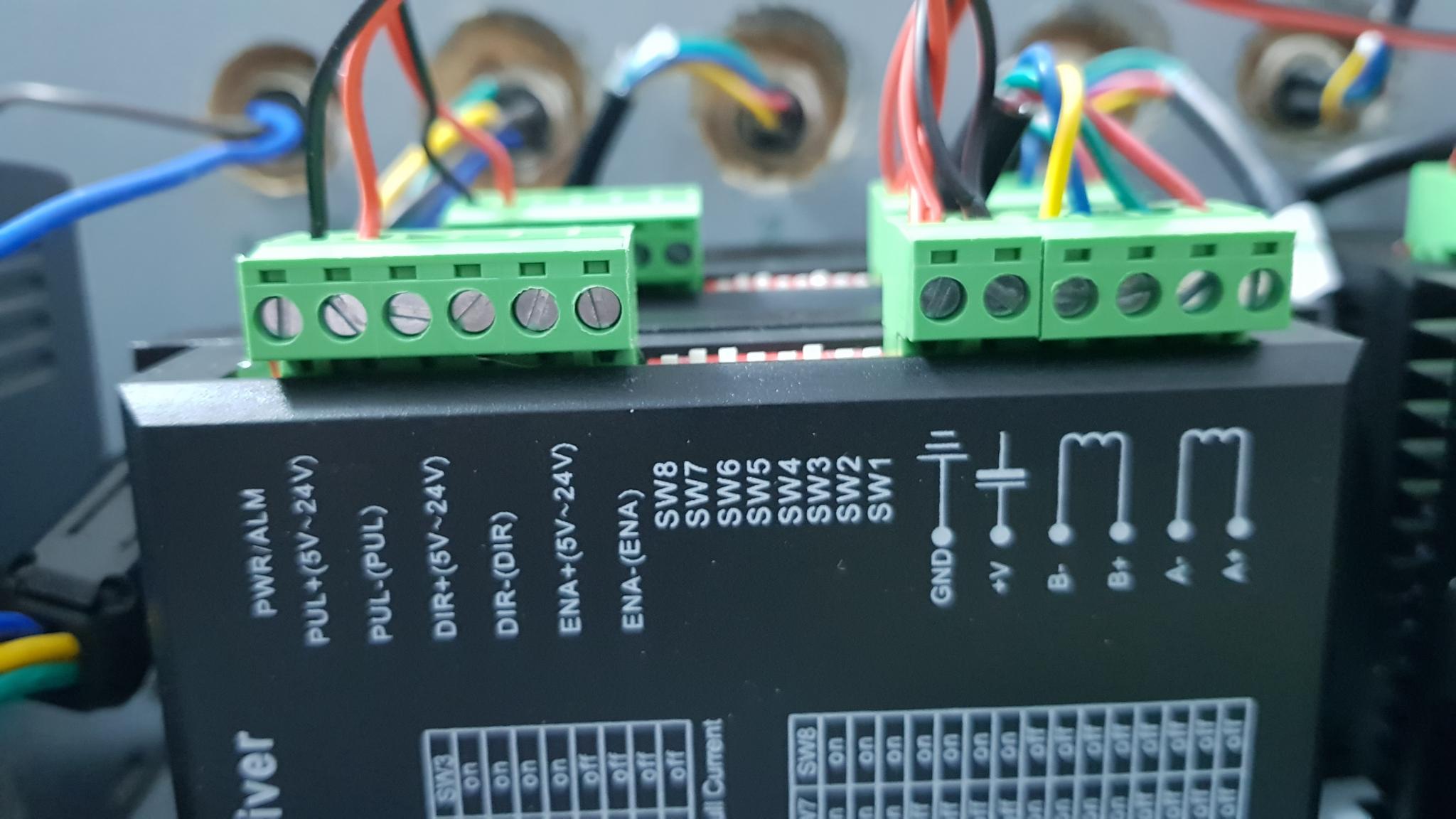

 This is typical of Chinese machines as they fit oddball motors which you probably won't find any info about. However, doesn't really matter too much because you will only have at best 36Vdc from the PSU so any drive with a 50Vdc max rating will work for you. Because you can't tell the motor current a little trial and error will be needed on the amps but this is no big deal as they will just run hot if too high and stall easily if too low.
These will work fine for what you need and will work miles better than what you had before. But before buying it's worth checking the voltage coming from the PSU
https://www.omc-stepperonline.com/di...or-dm542t.html

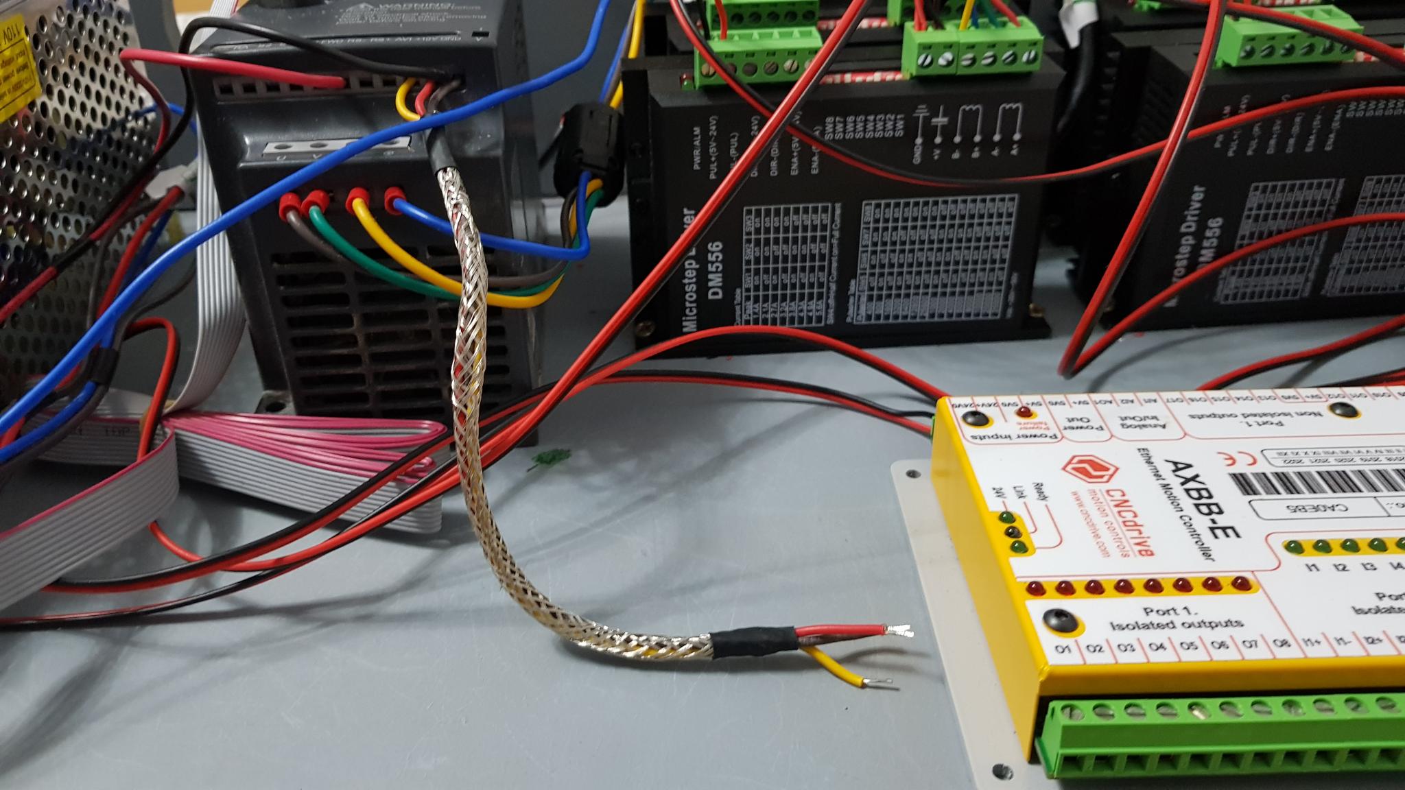

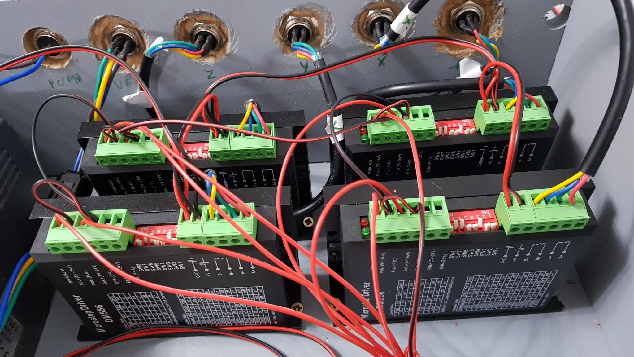

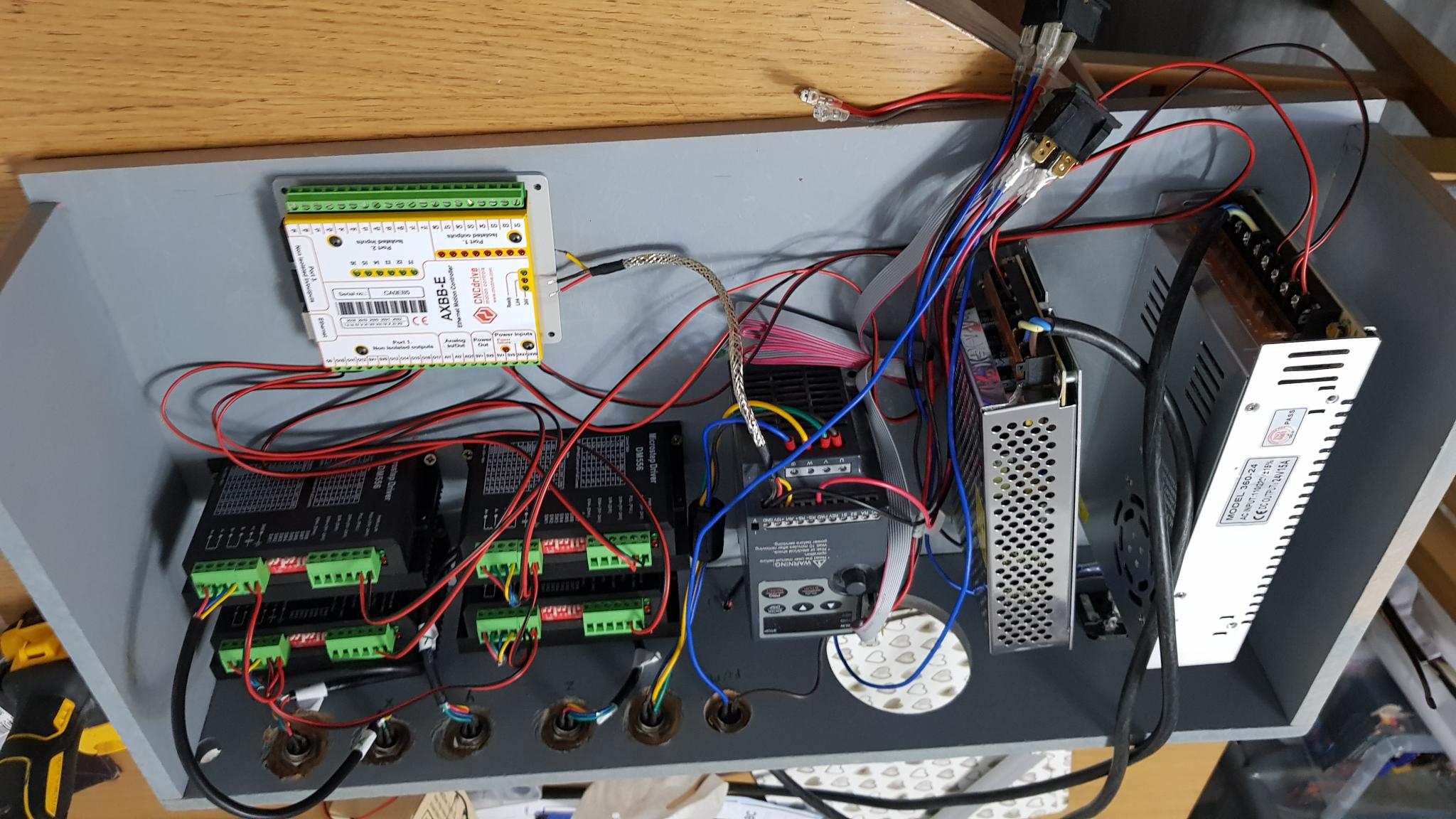

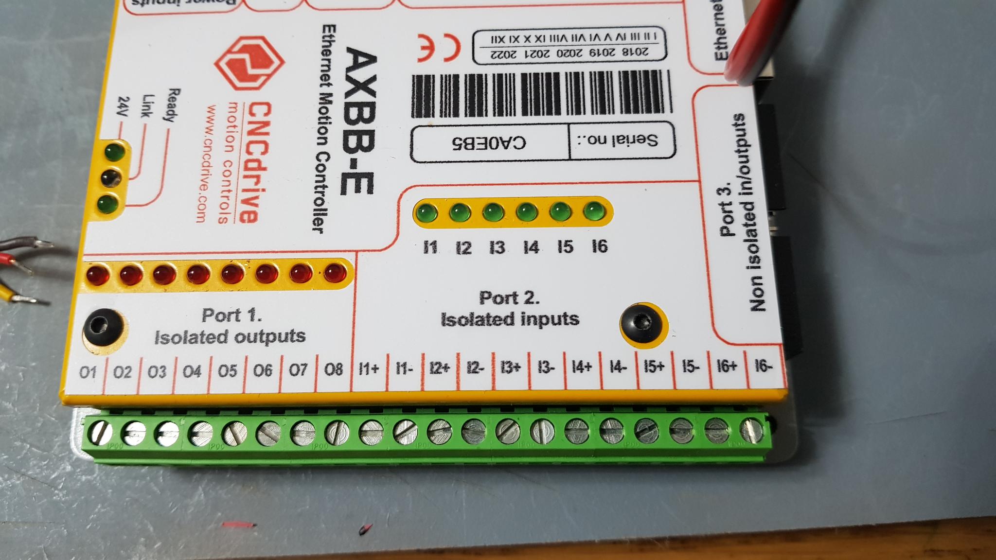

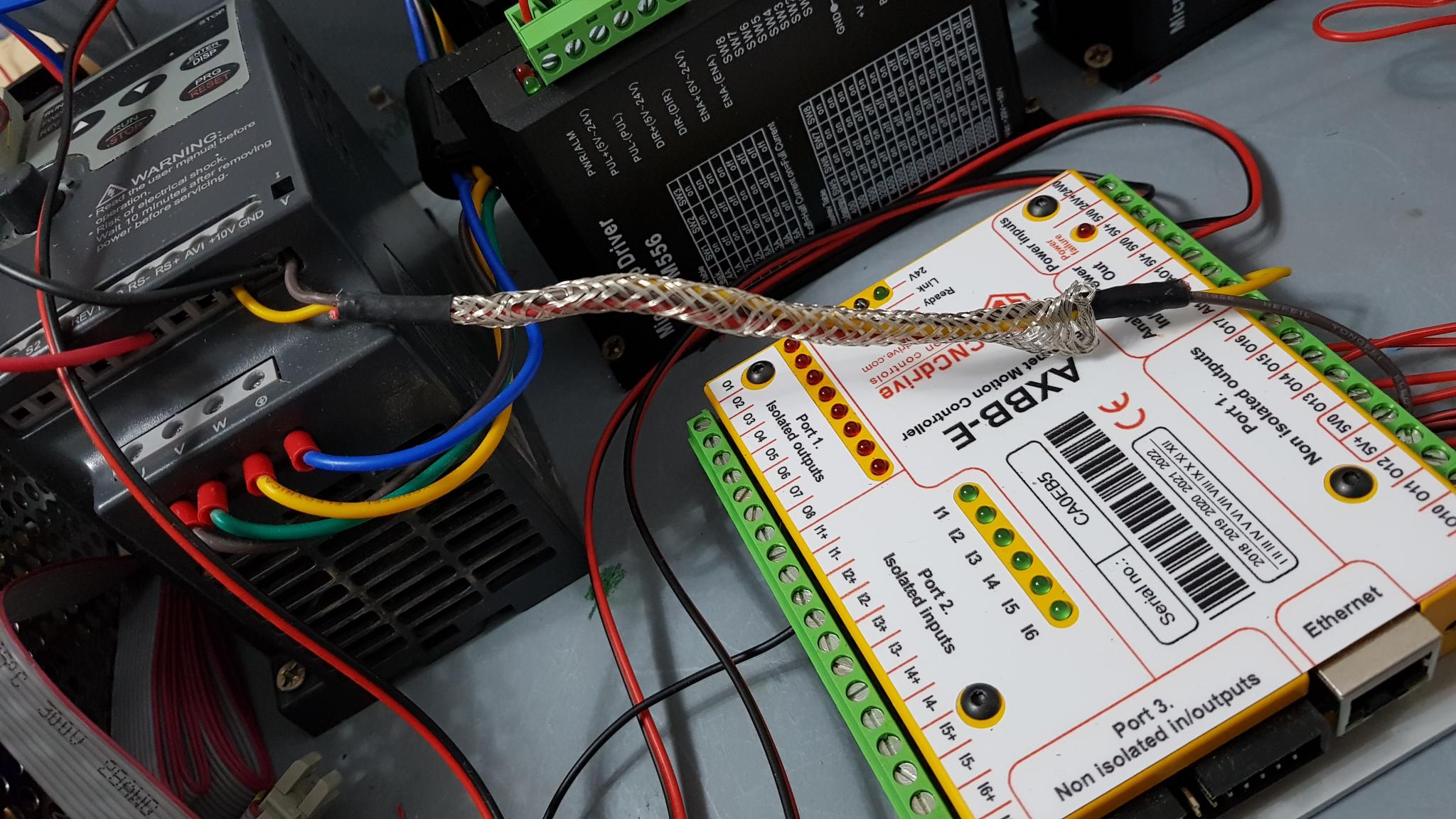

5 Attachment(s)
		Hi All,
        been having a go at building onto the AXXB-E attached are some pics and would like advice as to were I have gone wrong on the stepper drives, also the 3 wires lying by the AXXB-E are from the VFD av1 grnd and +10v were do i attach these to the AXBB-E, also  emergency stop and pump.
All the advice i have had up to now is much appreciated.
Attachment 30872    Attachment 30873  Attachment 30874   Attachment 30875  Attachment 30876
mrmacca
			Hi All,
 Be Careful if you don't know what you are doing because you can easily damage the controller if you connect up wrong. Don't turn it on until you are 100% sure it's correct, you can't afford to use a trial and error method here because you won't get a second chance once you let out the magic smoke.
I will knock you up some simple diagrams but it will be tomorrow now, I suggest you wait rather than have a go without being sure.

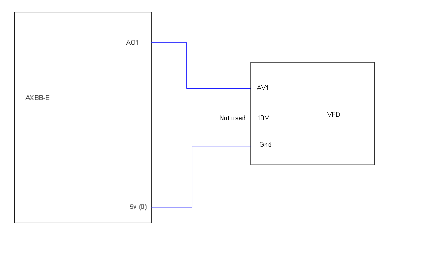

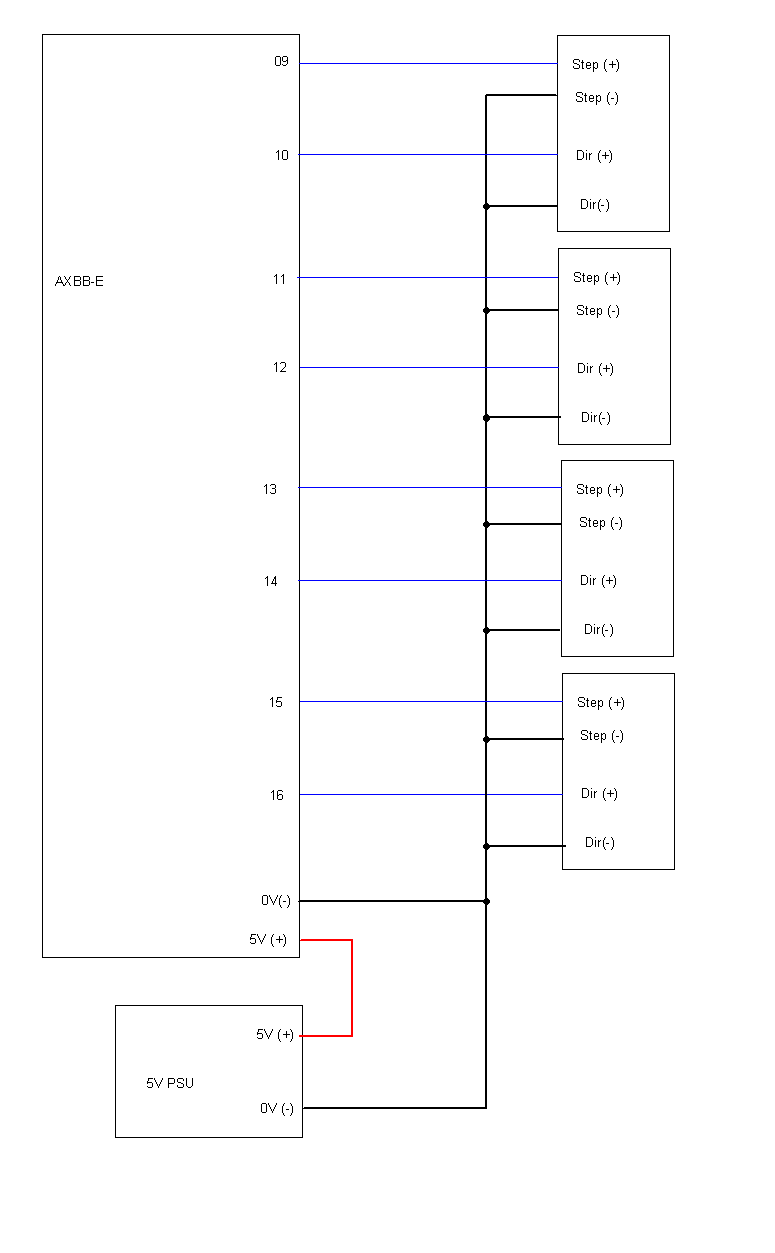

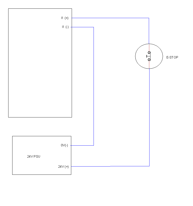

3 Attachment(s)
		Ok, here you go. I have broken each down into separate drawings.
On the VFD you don't need the 10V with AXBB so just remove the wire.
Attachment 30877Attachment 30878Attachment 30879
Edit: My drawings show Step which is Puls on your drives.
		Looking at the first two images, I'm concerned about the polarity of the supply to the stepper driver. It appears to show a black wire to +ve and red to -ve, although the 24V supply to the AXBB is correct. I can't see where these wires go on the power supply.
Neale
 Doesn't look like that on the images I'm looking at.? Maybe need to zoom in.?
Edit: Sorry just spotted you mean the OP pics, not the ones I posted last night. Yes looks wrong but depends on what it's like at the PSU.? Logic says its wrong
		I had replied to OP before I read your post, Jazz. Sorry about confusion.
Indeed, it depends on PSU connections at the other end of the wires but it's a disaster looking for somewhere to happen!
		Cheers Jazz,
                   no would not have turned it on and still wont till im sure , thats why i asked for help lol.
Actually had another read of the manual and spotted where I have gone wrong.
Cheers M8

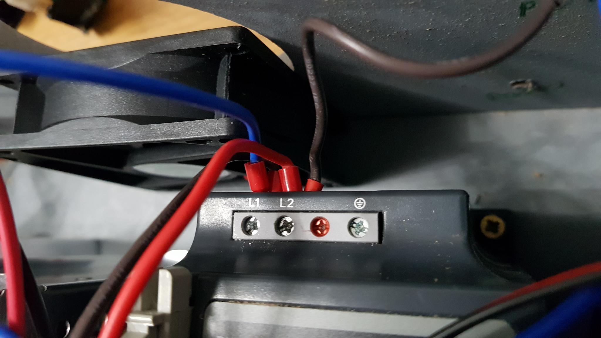

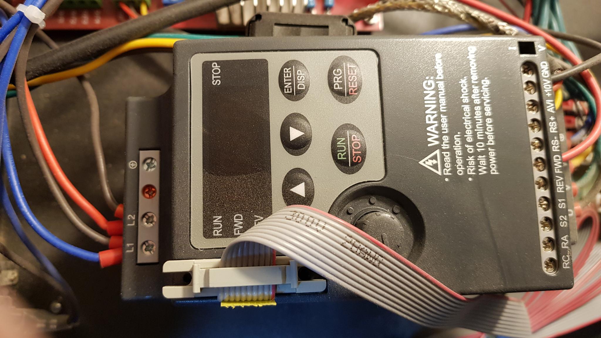

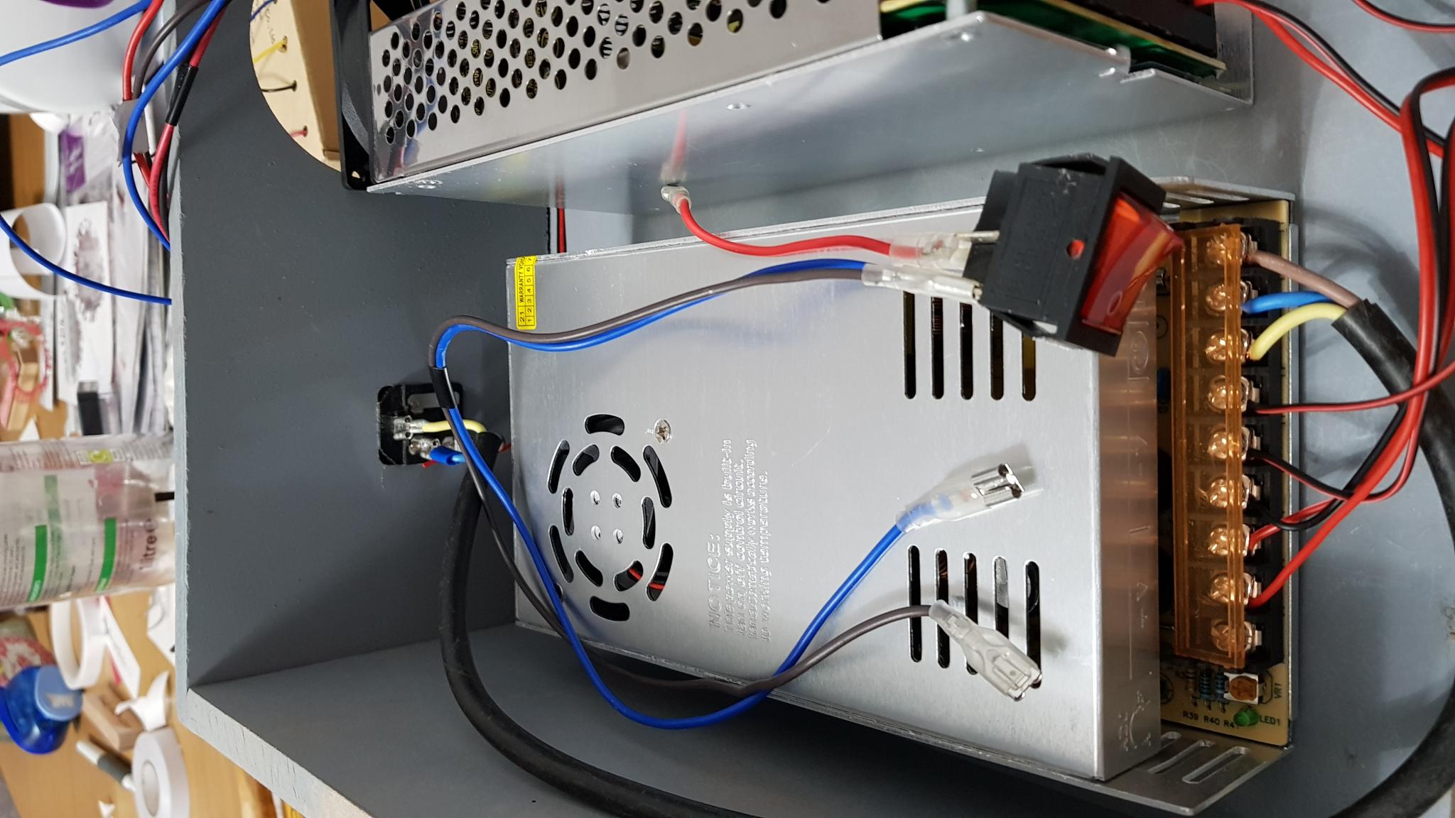

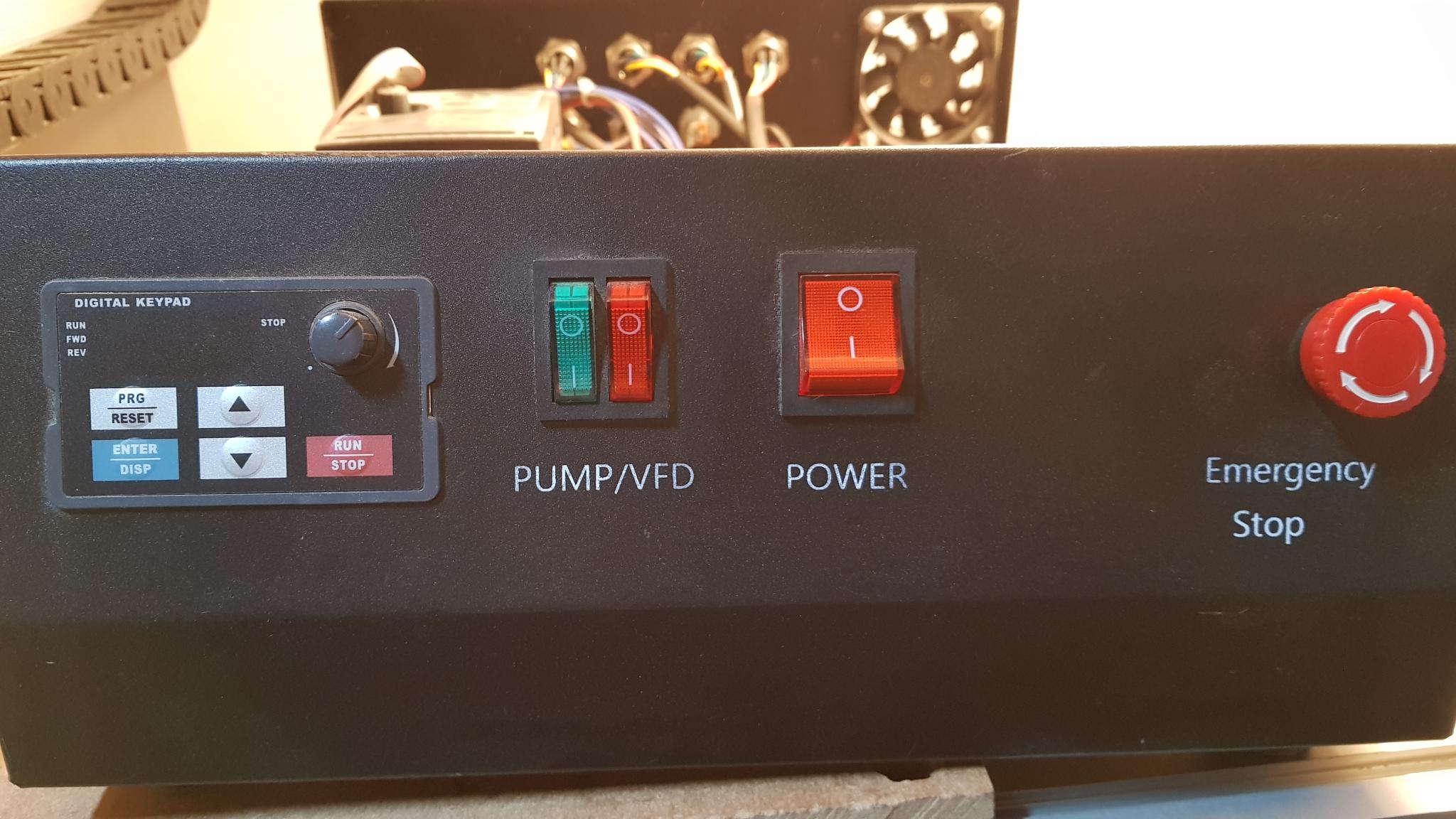

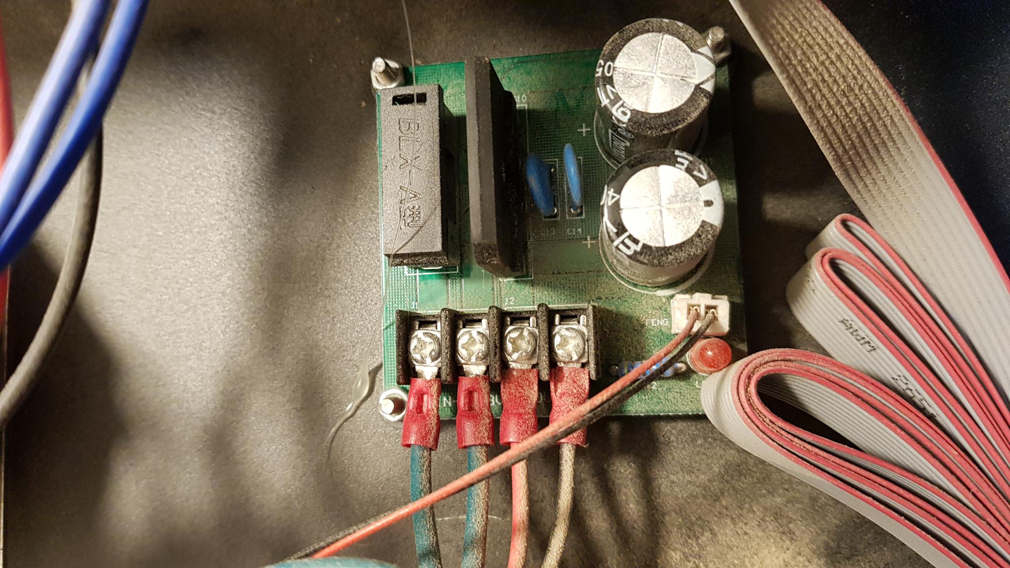

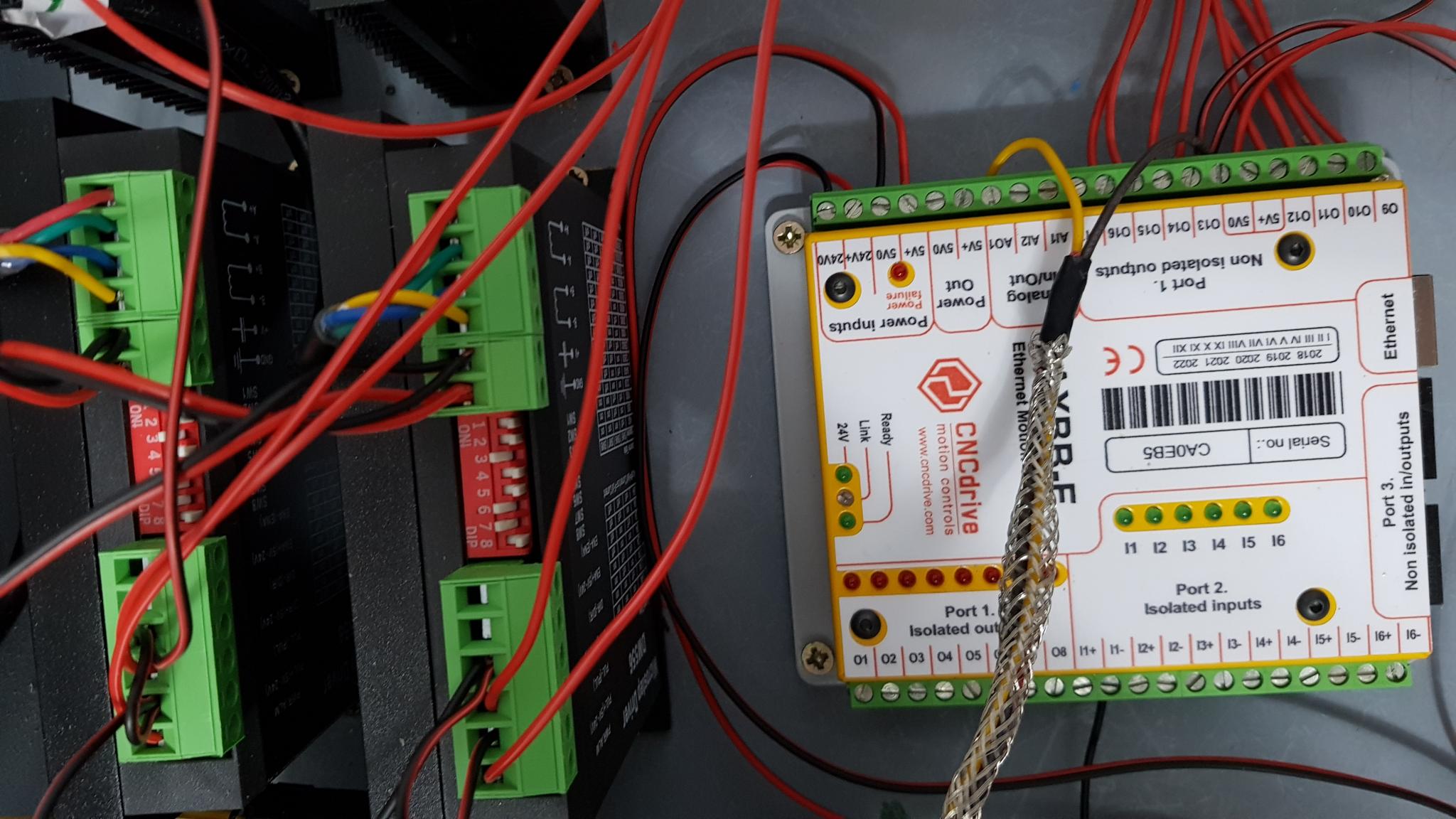

6 Attachment(s)
		im nearly there I think with wiring my Axbb-e , just got a few more questions.
Do I need to wire on off switch, if I do …how, or can I just plug in without it.
Wires coming from L1 AND L2 from back of VFD were do I locate these.
Is it ok to loop my 5v power supply from my 24v power supply or should I use separate supplies.
Cheers for all the advice and help..
Attachment 30880    Attachment 30881   Attachment 30882  Attachment 30883   Attachment 30884   Attachment 30885
mrmacca
 I assume you mean loop the mains input to the supplies. That is no problem, just do it carefully. I would advise using the correct size crimped spade terminals rather than trying to twist several mains wires together.
You can have a mains on/off if you wish. I use a 4 way dis-board with individual switched outlets with separate feeds for the AXBB-E 5V/12V supply and the 36V motor supplies.

 Cheers for that. any idea where the red and brown wires from the VFD L1 AND L2 go onto the Axbb-e
