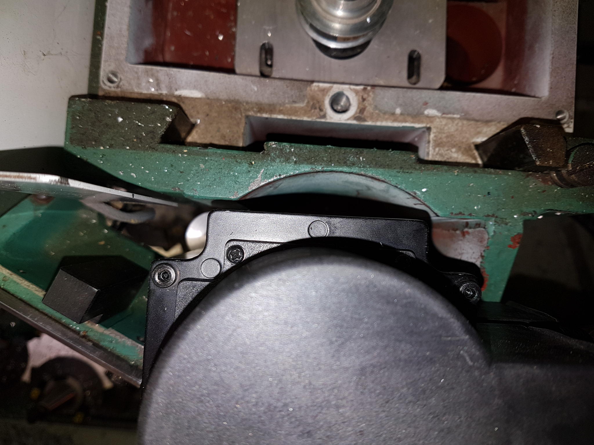

Some pics below. A bit rushed this weekend, let me know if you want pics of anything specific.
https://c2.staticflickr.com/6/5744/2...c6ee2732_b.jpg
https://c1.staticflickr.com/1/709/22...380e6efb_b.jpg
https://c1.staticflickr.com/1/610/22...4a0c93da_b.jpg

Ye, Ill share some stuff when I get home. I had to do a fair bit of test fitting due to the constraints of the physical space. I am using a 1.5KW Panasonic servo.

Direct motor replacement, 4400 rpm due to slight change in gearing.
Im in West London - UB108TE, feel free to pop around, Im home Saturday if you want to see my mess.
Ill take some pics anyways to share.

Did you get any pics of how the servo fitted?

I've just got to say, that typo made me smile :-)
LOL, I saw that after too but left it.
No, but will sort. I do have some older pics, lemme see if I can find them.

m_c
Attachment 21200Attachment 21201Attachment 21202
Difficult to show with existing pics. Ill take a vid on the weekend.

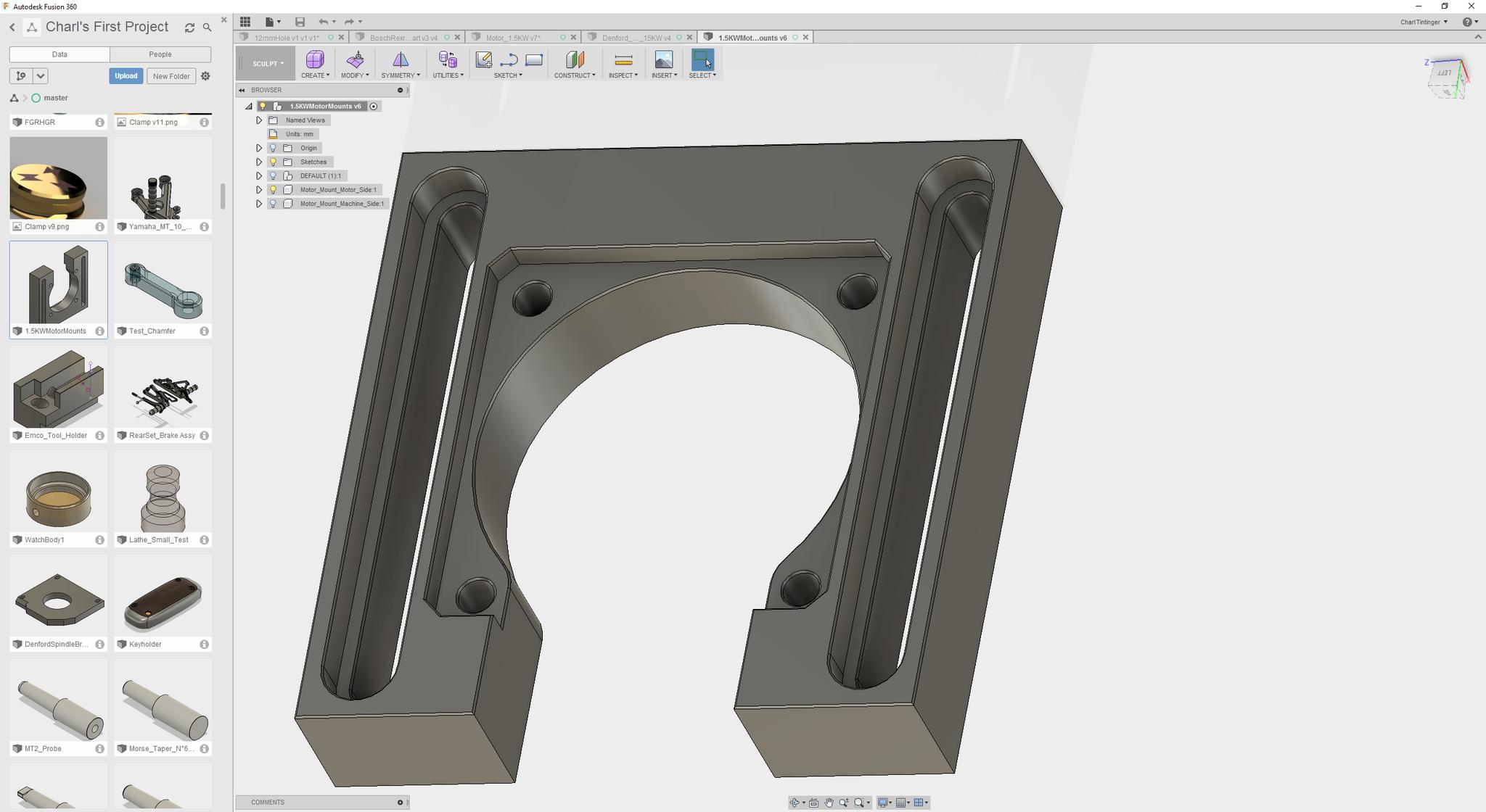

Tight squeeze, had to remove some material for it to fit and a pic of the bracket used.
Re: Denford Triac VMC with ATC Conversion / Fix
That's certainly a tight fit.
Any idea what size flange is on the motor?
I think a 100mm flange motor would squeeze in, however I couldn't find any with the power I was aiming for, so opted for a 110mm motor, and spacing it up.

Ill share the sizes tonight. Ive got the original flange drawn up as well as the info on the Panasonic 1.5 KW servo.
The plate that goes across for the DC motor is 115mm x 110mm (Depth).
The motor mount bolts are 81mm across from C to C. The recess flange is 100mm.
This is the motor mount for my Thor machine Y Axis (same motor as used on my Denford for spindle here).
Attachment 21207
