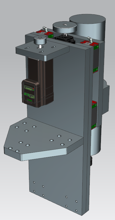

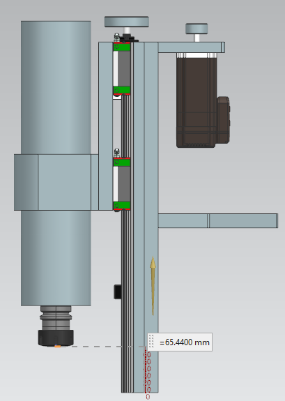

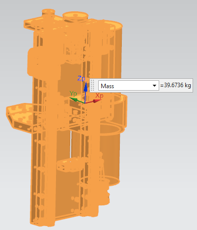

A 400W servo (rated at 1.2Nm @ 3000rpm) is plenty enough. 200W is also probably enough.
I will be using a Yaskawa 400W servo with brake for a 60kg Z axis (moving part only), driven by a 5mm pitch ballscrew @ 1g accel and 20m/min.
The servo has a peak torque of 4Nm, and moving this axis will only require about 2Nm peak.

In post #2 http://www.mycncuk.com/threads/13448...672#post114672 you said that these 180W servos that I had bought were only toys and that 400W would be the bare minimum. I think you were talking about a little bit different design in that case so I can just ignore it, correct? Anyway the price difference between a Delta 200W servo and a Delta 400W servo is minimal.
Will you be using direct drive for that Z-axis? I checked that those servos are rated at 3000rpm, so direct drive with 5mm pitch would result in 15m/min. Also what diameter will that ball screw be and is it possible to spin it that fast?
Your moving weight sounds extremely heavy! Are you designing it in steel? How did you calculate how much Nm will be needed to move the axis?
Wow, this turned into a lot of questions, lol!
Re: NordicCNC's build log
A JMC 180W might be enough power wise, but industrial servos are much more sophisticated. Encoder resolution, motion smoothing (much needed for high accel when the controller doesn't handle S-curve motion profiles), vibration suppression, ...
To be honest I also had a different machine in mind from what you're planning when you stated your requirements :)
For calculating the required motor, I simply plugged the numbers in Yaskawa's calculator (SigmaSelect).
It's a 2005 ballscrew coupled with 1:1 pulleys (I would have liked to go direct-drive, but didn't have enough space to inline the motor). The axis can reach 30m/min because servo max speed is 6000 rpm. Ballscrew critical speed is not a concern since it's short (400mm) and could in theory handle 13'000rpms.
Yes the axis is all steel, but the spindle is only 2.2kW ISO20 30krpm. The goal is high-speed aluminium milling.

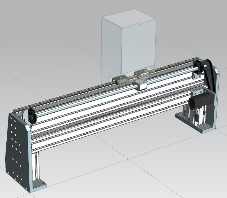

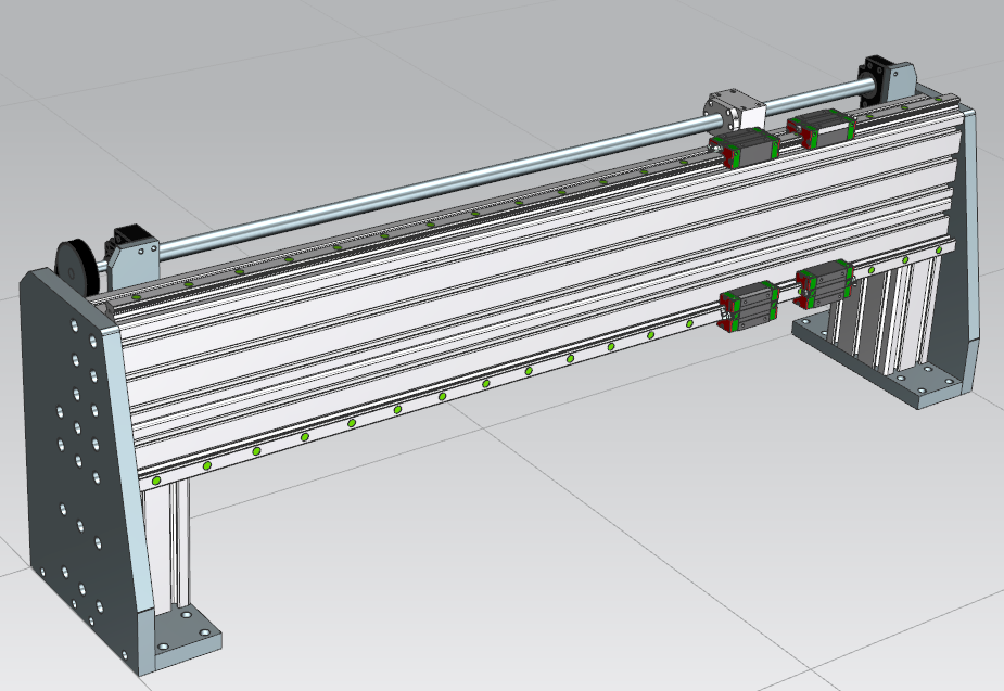

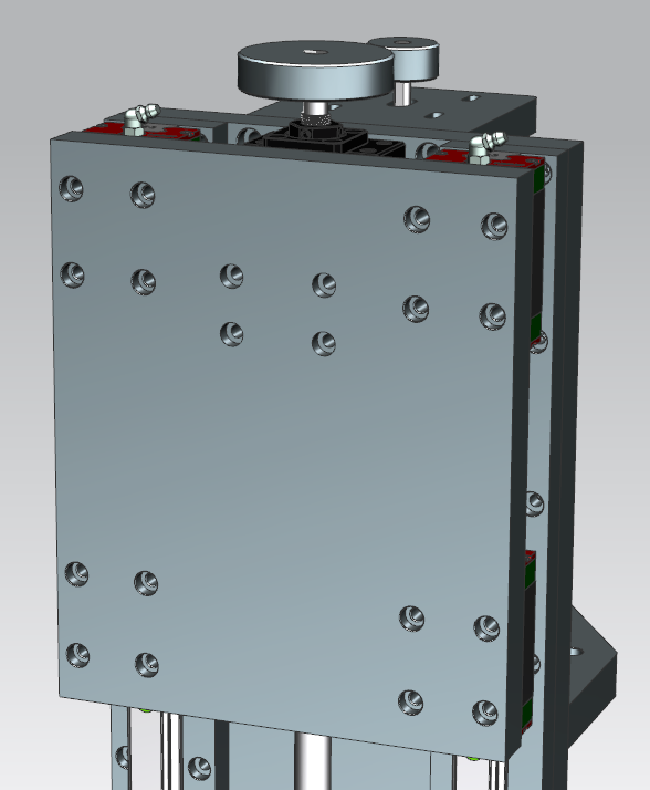

Some design progress has been made.
X-axis design
Attachment 27591 Attachment 27592 Attachment 27593 Attachment 27594
- L-shape gantry with 120x80 (heavy) Item profiles 1200mm long, with approximaterly 950mm travel length . The profiles for the L-shape are bolted together from the bottom. I plan to use aluminium plates as guides in the T-slots. Should these guides be fastened somehow or is it enough to insert them into the slots and shim away the clearance?
- High side gantry profiles with 120x80 (heavy) Item profiles, 160mm long. These are bolted to the bottom profile of the L-section, from the top of the bottom profile.
- 20mm aluminium gantry side plates, bolted to both the L-section and the high side gantry profiles. It is also bolted to the bottom plates, that will be mounted to the Y-axis bearing plates. The purpose of the bottom plates being separated from the Y-axis bearing plates, is to allow some adjustment later when squaring the gantry.
- 20mm HIWIN linear rails.
- 2010 ballscrew, 1150mm long.
- Delta 400W servo motor with a 2:1 reduction, to limit ballscrew RPM.
Attachment 27595 Attachment 27596 Attachment 27597 Attachment 27600 Attachment 27598 Attachment 27599 Attachment 27601
Y-axis design will continue from here!

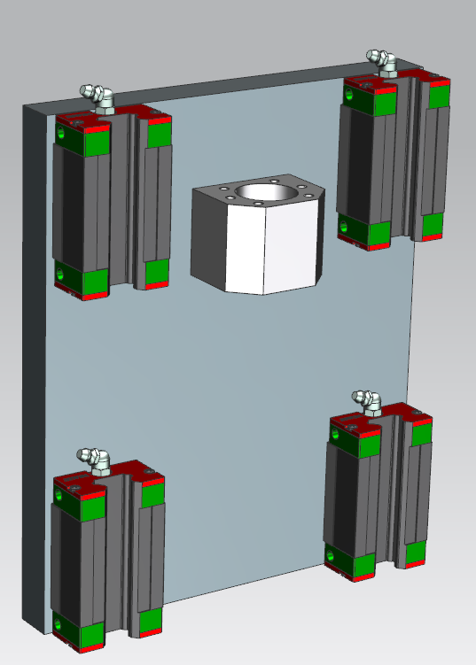

I would use HGW bearings rather than HGH, they offer more support.
JAZZCNC
Got it, that is easy to change. Does this apply for the Z-axis as well?
NordicCnc
Yes and no, Yes if you have room but I only use them on X & Y as it can make the Z a little wide.
You don't need or want 6 counterbored holes in the lower gantry just use the 3 furthest away from the gantry side and the center front one, you can miss the out the center bolt through the gantry side or put it in but with short threads. Reason being the bolts going through gantry side clash with bolts and it's more important you get good fastening into sides so longer bolts needed. Between them, the gantry is going now were trust me.!
Also with the ball screw spacer plates pay careful attention to fastening bolts and that you can actually access them with BK bearing and screw in place because you'll need to adjust these on the machine when setting alignment etc.
6 Attachment(s)
JAZZCNC
Good notice! I have corrected that now and I will use shorter threaded bolts for the center ones (red arrow).
Attachment 27604 Attachment 27605
JAZZCNC
Yes, I should be able to access those at anytime with current design.
Attachment 27606 Attachment 27607
I have also replaced the guide carriages with the wider version, as you suggested.
Attachment 27608 Attachment 27609
Thanks for your feedback, I appreciate it!

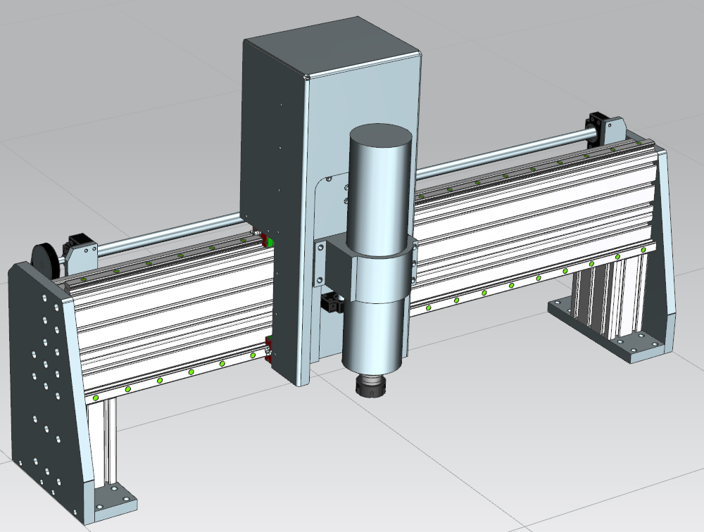

13 Attachment(s)
Y-axis design
- 1600mm long, 160x80 (heavy) Item profiles will be used for the sides, onto which the linear rails are mounted. Travel length is approximately 1400mm.
- 1065mm long, 160x80 (heavy) Item profile is used for the front.
- 1065mm long, 80x80 (heavy) Item profiles will be used between the 160x80 side profiles. The base frame profiles are mounted together with front/end plates and 80x80 angles.
Attachment 27634 Attachment 27635 Attachment 27636 Attachment 27637 Attachment 27639
- The plates onto which the guide carriages and the ball screw nut housing are mounted are separated from the gantry. The purpose is to allow some adjustment later when squaring the gantry. It will also separate the aligning process of the Y-axis ball screw and linear rail from the gantry squaring process. This will make the aligning easier.
- 20mm HIWIN linear rails with wide guide carriages.
- 2010 ball screws, 1500mm long, with BK15/BF15 bearings.
- Double Delta 400W servo motors with a 2:1 reduction, to limit ball screw RPM. 20T and 40T timing pulley's will be used. Preferably with taper-lock mounting.
- Same servo motor brackets, BK/BF bearing spacers and ball screw nut housing concept are used as in the X-axis. Commonality and re-usability is the goal here.
Attachment 27638 Attachment 27640 Attachment 27641
Attachment 27643
- The spindle will have a 100mm overhang at when the Y-axis is at the end of the table. The purpose is to be able to mount work pieces vertically, for dovetail machining.
Attachment 27644 Attachment 27642
- The table surface I am not sure about yet. Either I will install a HDPE sheet or and MDF spoil board.
- The complete machine will later be mounted to a sturdy metal bench/frame. Adjustable feet will be used.
Attachment 27645 Attachment 27646
Originally I intended to have the Y-axis linear rails side mounted, to make the footprint as small as possible and to protect the rails from dust and chips. I was informed that alignment is significally harder with side mounted rails, which is why the rails are now top mounted.
