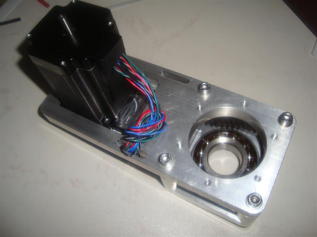

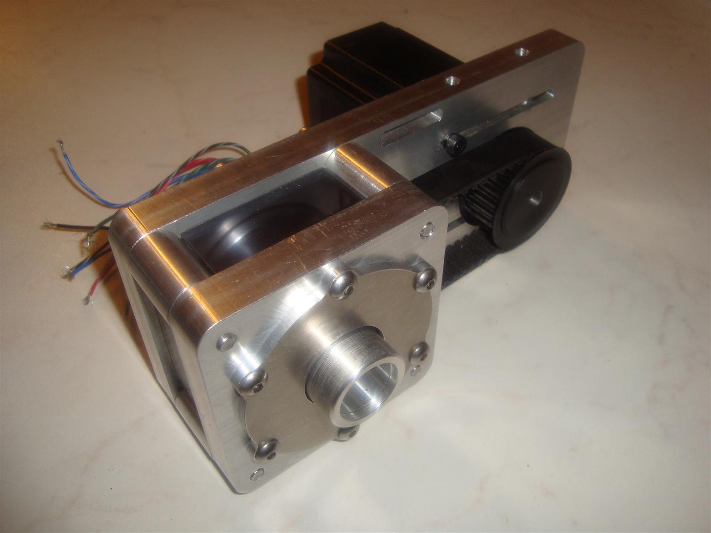

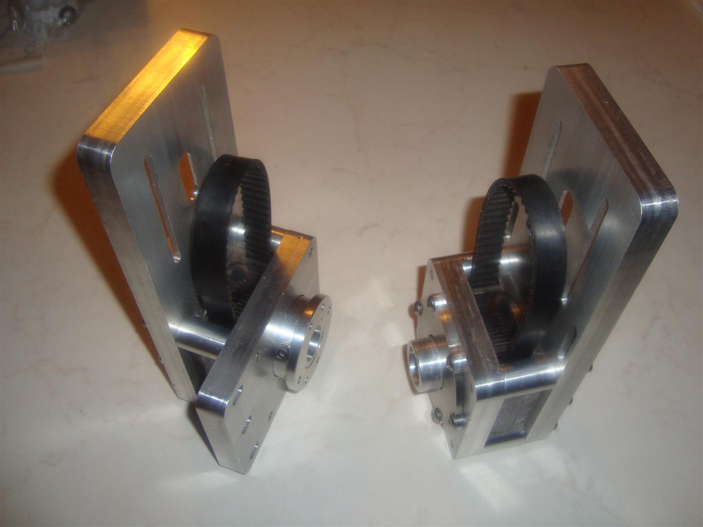

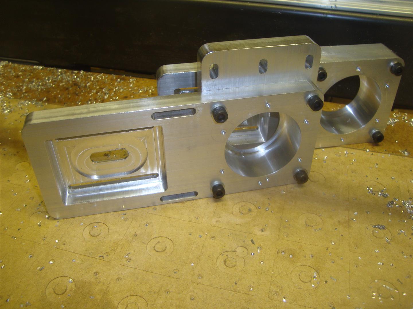

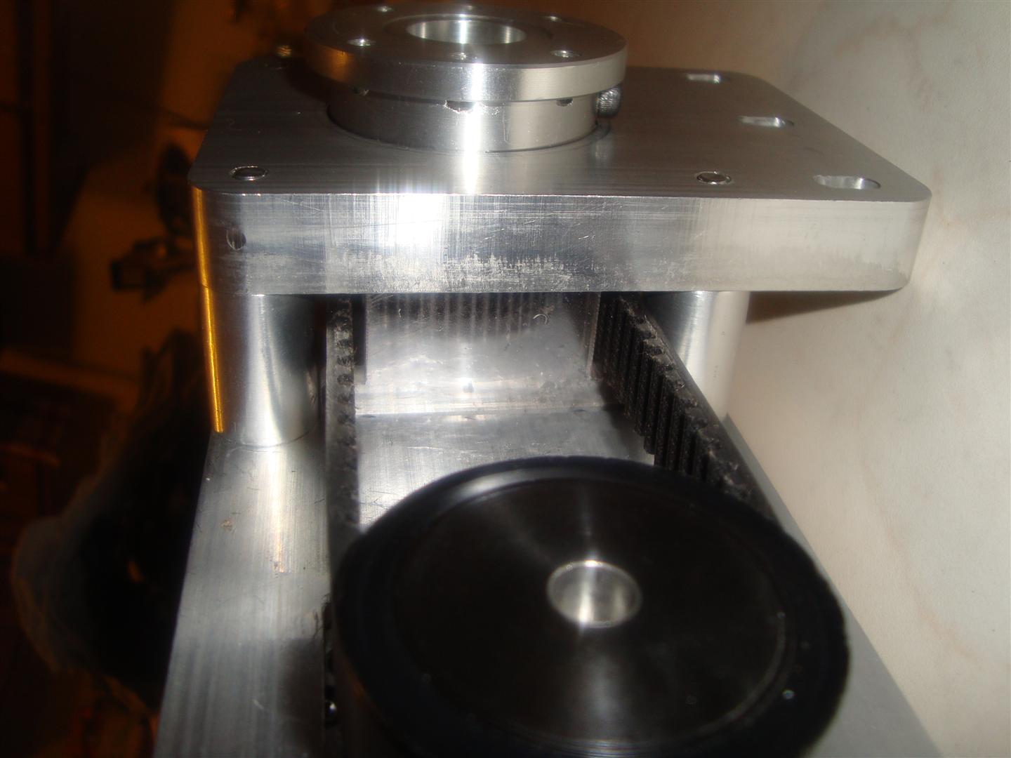

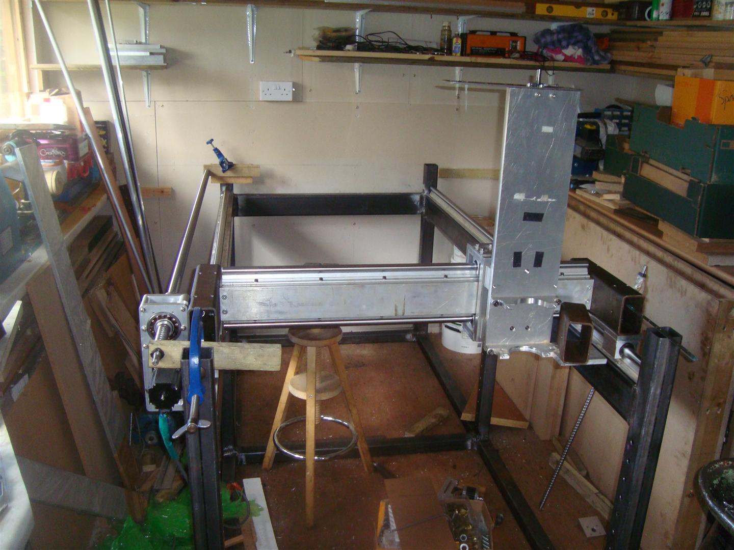

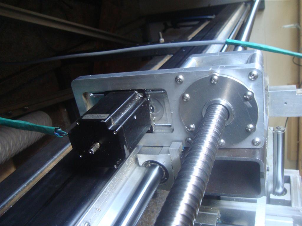

I'm just finishing a 10x5 machine with rotating ball nut so it's good timing to ask this question.
The first thing to mention is how much the screws sag under there own weight at 10ft long. With NO tension on the screws, it's massive but even with tension on the screws which you must have, there is still more Sag than you would probably expect.
So when the machine is at Rapid feeds and when axes are near the ends it leaves a long length of screw unsupported, so the screw can still vibrate.
On the machine I've built it uses a 25mm diameter with a 25mm pitch with a 1.5:1 ratio. I'm using 220V closed loop steppers spinning which spin between 1500-2000rpm. The machine is tuned at 30mtr/min(1200in/min) and will reach 40mtr/min((1575in/min) however I wouldn't suggest that speed and here's why.
The ball nut was never designed to spin at those rpm's so while you havent got the critical whip factor to deal with you still do have to consider the nut speed and what it was designed to spin at. Most ball nuts expect to be fixed and are designed for low spinning screws. So with Servo's spinning at 3000rpm or higher then you will have trouble with premature wear. Also, the alignment will be much more critical with higher RPM's.
My advice is to use a higher pitch then apply a ratio to lower the rotation speed of the ball nut while still getting the rapid feeds you would like. You will also get the advantage of increasing torque so you can lower the size of servos.
Now, where it gets tricky is with the Ball screw size. The larger Diameter screw will probably Sag more under its own weight so more tension will be needed. So you will need to design strong brackets that allow for the screw to be adjusted for alignment.
My suggestion is to go with a 32mm pitch and ratio of 2:1 that will give the equivalent of 16mm pitch and 1500rpm at the nut with 3000rpm motor. Giving just short 1000in/min which could be pushed up 1575in/min with 5000rpm giving 2500rpm at the nut which I would suggest is pushing the limit.
Hope this helps. Oh and this machine is vertical but that doesn't make any difference.

Kind of yes but no, or should say maybe your misunderstanding what's being said or maybe I'm not putting it over clear enough..
Yes, 32mm pitch with 2:1 ratio will give the same linear torque as 16mm pitch 1:1 so torque is canceled by pitch difference like you say.
However, when I say Torque is doubled so the smaller motor can be used, what I'm referring to is that if 1:1 the 32mm pitch would require a larger motor to give the same linear force as 16mm pitch. So the ratio doubles the torque and allows the smaller motor to have the same linear force as 16mm pitch.
The trades off's and gains are that 32mm linear movement halves but so does rotation speed of the nut. So the pay off is that you get the same feed and torque as 16mm at 1;1 but with half the rotational speed of the nut or screw. This is the main goal to reduce whip and stress on the ballnut.
Hope that makes more sense.!
HI JAZZ thanks for your insight regarding my question just talk with my ball screw supplier he suggest me to use 4040 for 3.2meter axis and 3232 for 2 meter axis..and i might follow their suggestion regarding that if budget is not constraint..anyway maybe i opt for 3232 all axis 4040 is really expensive
Do they know you are rotating the nut and tensioning the screw.? Makes big difference.
This is the first 10x5 machine using rotating ball-nut I've built, I've built plenty of 8x4 and the difference between them really surprised me.
The secret is keeping the nut rotation speed down and getting a good tension on the screw with nice straight pull.
Good luck

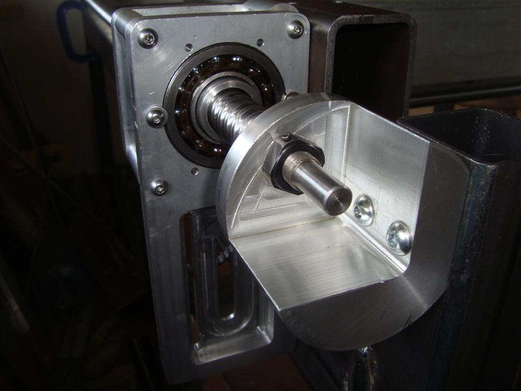

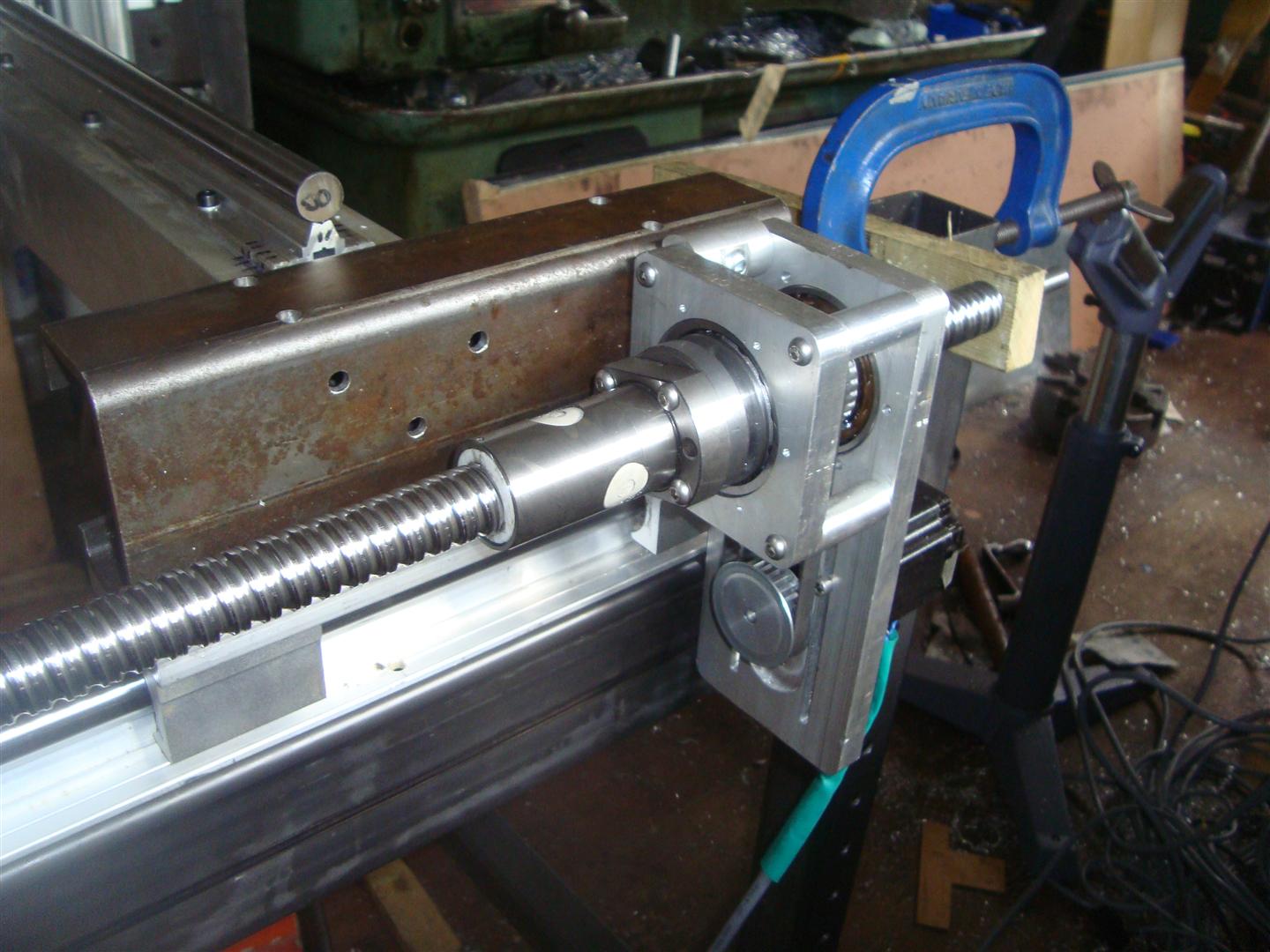

Don't need end bearings because not spinning the screw. The ends need to be either externally threaded or internally-threaded so you can tension the screws. I've used both methods on different machines and prefer externally threaded as can get more torque.
The force required to take Sag out over 10ft is considerable so make sure the brackets holding the ends are substantial and adjustable so can align screw in two planes.
Can do either but using a larger motor usually doesn't cost less because requires larger drive and often more volts so larger PSU.
However, on long machines rotating nut wins hands down and requires a belt connection, so the ratio is no extra cost. Rotating the screw on the long machine means much larger ballscrew is required and this really starts to ramp up the costs because everything scales up with it, Bearings, couplers, motors, drives, PSU
Even then a rotating the screw system cannot achieve the feeds a rotating nut can.

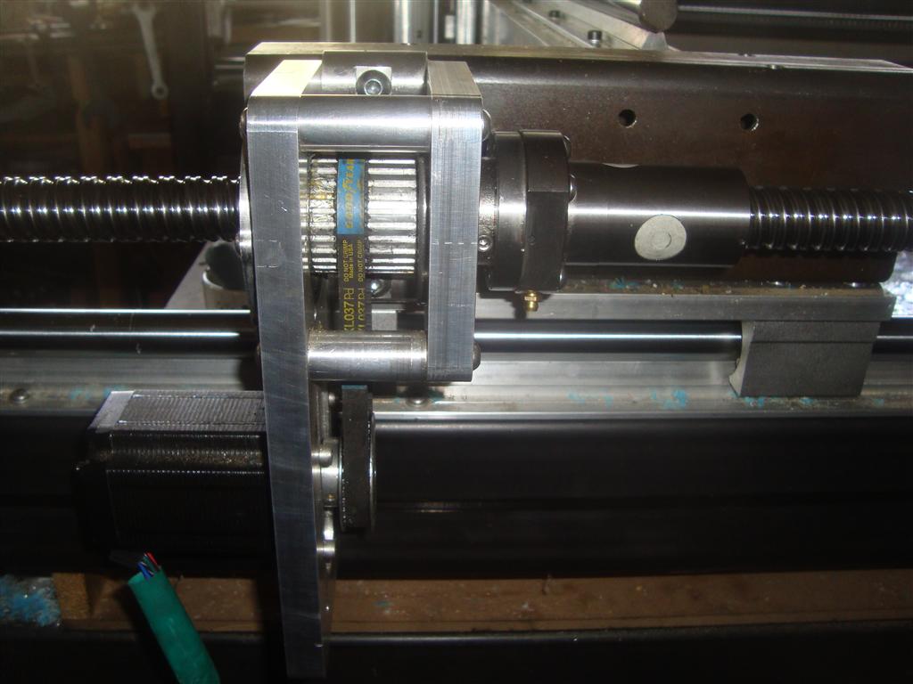

Certainly worth a read but what helps with rotating nut is to get shortest length Nut possible.
It's also critical that the Shaft as a Flange which is machined perfectly concentric to the Nut otherwise concentricity to the screw is misaligned so causes big vibrations.
What's the thinking behind the shortest possible nut please?
The concentricity is an obvious thing and might rule out some of the cheaper offerings if my experience on the machine I've just completed is anything to go by. Having set everything up and got it working smoothly I thought I'd spin one ballnut through 180deg to get better access to the lube nipple. Major fail, that side of the axis got really stiff, it turned out that the casing/flange of the ballnut was something like 1 or 2 degrees out of alignment with the axis of the screw.
access/interference and balance/inertia mostly, it's no big deal and depends on the design to some degree but shorter is better in my experience.
It's not always the case obvious to everyone that's why I mentioned it. However most ball-nuts, even the cheap ones, have a machined reference surface on the outer body which you can chuck upon and skim flange if needed. Thou I've not had any issues if honest.

+1 The advantage of roller bearings is the huge radial load they can take, in this case the axial is more significant I think. However there are one or two sizes of tapered rollers that are easily available at a very attractive price which might swing it ;-)
I agree with Boyan and we Both have experience of using rotating ballnut design, so you might want to listen. That design and those bearings are not good for this application because of things which have been stated. They will work ok, but they won't last ok, the forces are in all the wrong places so between this and the heat generated because these ballnuts are being run in ways they where not designed to run it will impact the life and performance.
But you could say what do we know.? In which case go for it.!

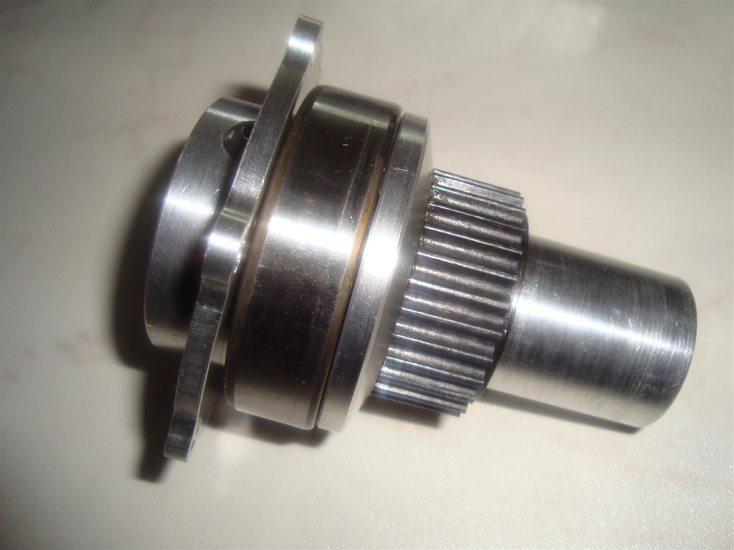

What do you think of that design for a 16mm ballscrew? Maybe the pulley should go on the right between the bearing and locknut so I can use a smaller pulley.
The bearings are double row 3805 2RS 25x37x10 spaced 35mm apart.
It is just a copy of the Fenergy angetriebene Mutter and I will probably buy that one anyways.
I just extended the spacing of the bearings and didn't copy other stuff that well.
